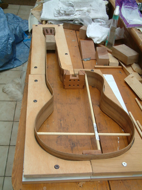

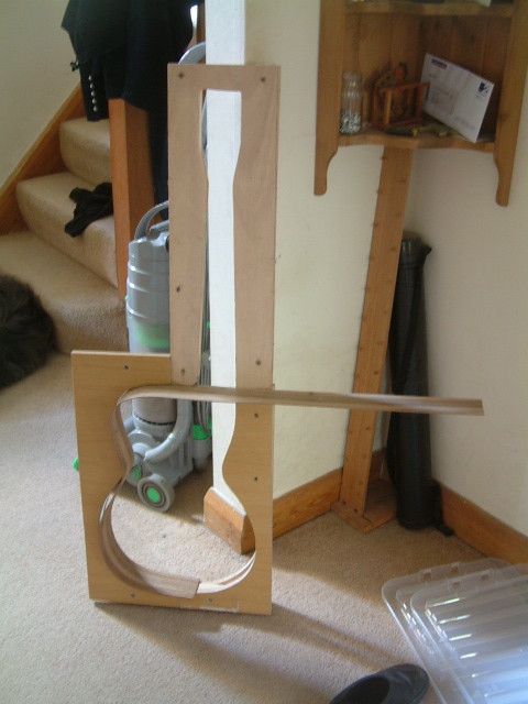

I use the cut out section of the mold like this.
I can bend two sets of sides at a time. One set goes into the mold and the other set gets clamped into the jig in the pic to hold the sides in shape.
Now for some light entertainment.
Whoever first guesses what wood is in that jig I'll send a figured Gidgee bridge blank.

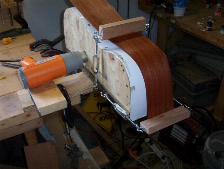

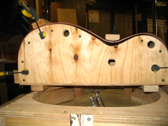

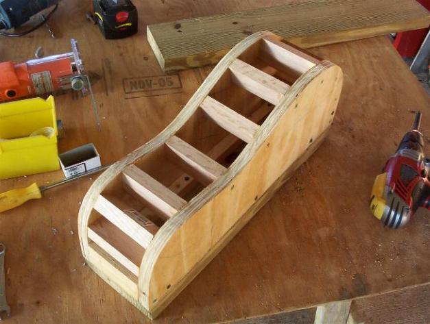

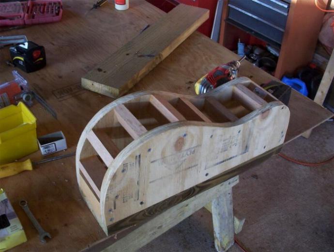

I do something similar. I cut my forms 1/8" to 1/4" proud on the inside and use a spindle sander chucked into my drill press to finish one of the pieces, then use that piece with a flush trim bit and a template attachement to finish the other pieces.
I use the inside cutouts for my bending forms. I take 2 sides and screw them into a 2x6 base. I then screw in some 1x2 cross braces and cover the whole thing with thin aluminum stock... the kind of stuff the big box hardware stores sell as kick panels for screen rooms. Takes about 20 minutes to put the whole thing together. My heat source is a cheap HF heat gun. I drill a couple of 1/4 holes in the opposite side to prevent back pressure from ruining the gun. The whole thing works very well. The aluminum does a good job of transferring the heat. Here's what mine look like:
Different angle:
I screw the thing to a narrow plywood plate so I can clamp it to my workbench.
It's worked very well for me, FWIW.

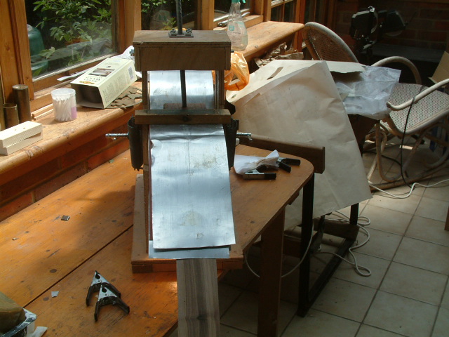

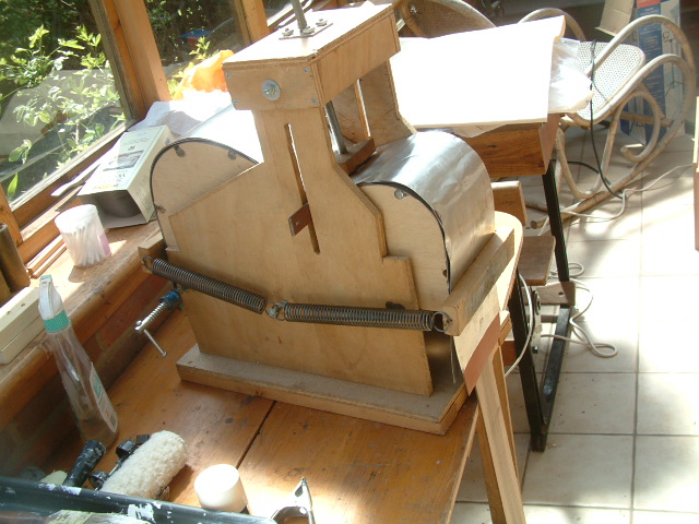

This post by Ken McKay on bending double-bass sides should be of help/interest to you. For the harp guitar I am building I am using the shape of an existing guitar and for the bass side I bent the waist and lower bout in the fox bender with the guitar form, for the treble side I bent the waist, lower and upper bouts in the Fox Bender. Then I used the hot pipe, and finally used the pieces inside the mold with the heating blanket sandwiched between two bending slats to press to the final shape. You have to be VERY VERY careful doing this to have the right protective clothing so that you don't burn yourself (or set fire to the bench ). It doesn't take very long - mist the sides, press the heated sandwiched blanket against for a minute or so and the use various spreaders to hold the shape while it cools - I used thin dowel rods. Here's a few pics that might help:
